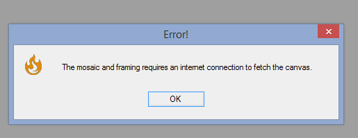

Framing and Mosaic Wizard fails to fetch image despite internet connection
When, I click fetch, I get the error as below. Also, I couldn’t report the problem using the tool in SGP. I got a similar error regarding internet connection when I tried to report.
I confirm that my internet connection works. Hence this post. Here is the log file link

Hello! Maybe check out my post regarding the same issue in Sept 2020. I run a VPN and had to disconnect the VPN in order to get the F&M image.
[https://forum.sequencegeneratorpro.com/t/connecting-to-internet-w-f-m-wizard/13633]
Bos
Thanks Bos. The link says “Not found”. I am not so well versed with technology. I am using my mobile internet shared through Hotspot. Is that a VPN?
When you look at the wifi connection on the computer, does it say explicitly it is connected to the Internet? Having said that, I had an intermittent connection this week. It worked on the third attempt, though I was connected to the internet all the time through my home network.
Yes buzz. It stays connected and also says is connected. I have had no problems or connection issues so far with anything except SGPro.
I’ve been having the same issue randomly on one of my three setups. The internet connection is there, as I usually have a browser open with a connection to a weather site.
I think this might be an issue with the database SGP fetches the images from, could also jsut be an overload or a slowdown of some part of the connectivity, which will probably lead to a timeout and subsequently this mesage in SGP.
