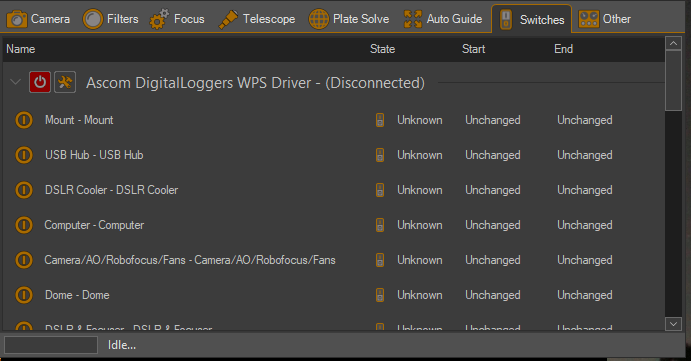

The above is Pegasus, not DigitalLoggers. Here is the normal appearance of the DigitalLoggers switches:
Screenshot 2024-05-29 062752

None of that looks right to me. It may be “right” but I don’t think so. What looks right is the screenshot that i posted which has the ASCOM profile above it. That shows all the switches but doesn’t show the header. Here’s what it looks like:
Screenshot 2024-06-03 100004
Note, it says WPS Driver and doesn’t have the “series” description. BTW, I can run a “clean” sequence (no orphaned switches) with switches enabled and get the initiation error. With all switches set to “Unchanged”, no error. So it’s trying to initiate one of the “series” switches which is not even shown in the “clean” sequence list.
