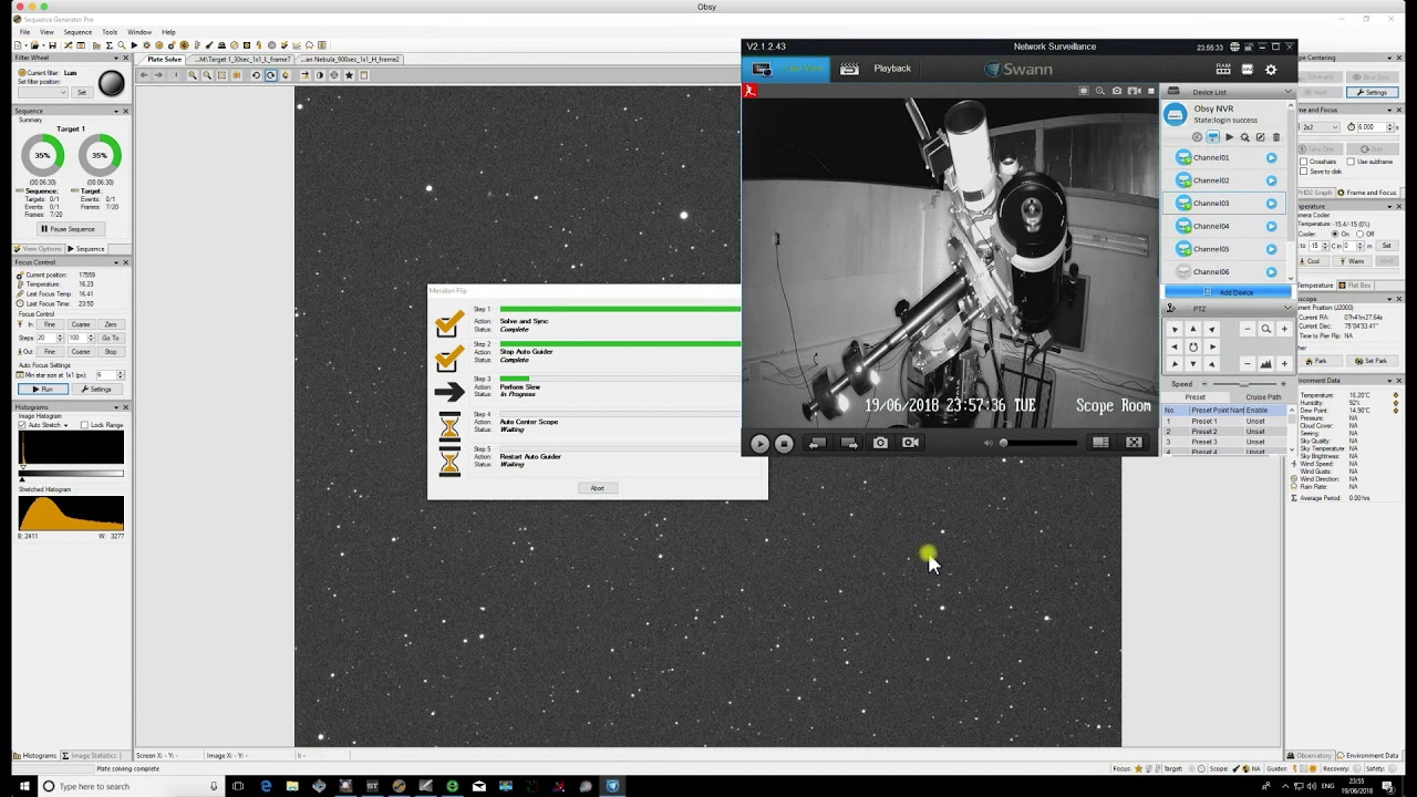

It seems to me that the flip is iniated externally to SGP in other words by you mount’s firmware or a driver setting. My current mount incorporates a mandatory flip (or ceases tracking - I have a choice) in order to protect against a pier collision. I do have some control over the meridian limits so I have to ensure that SGP initiates a flip before the limit is reached.
This Youtube tutorial explains it quite well
Hope this helps
