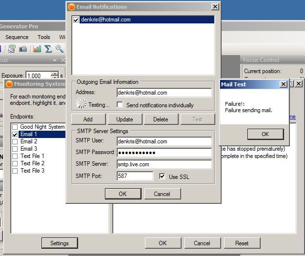

Anyone out there have any idea why I get a Failed Test message immediately when I click the test button. I have followed the instructions which seem pretty straight forward. I had this feature working fine for the longest time until I had to replace a hard drive.
I am using ATT , Hotmail, . SGP fills in the rest.

Please see above log posting. I get a "Failure Sending Mail " message instantly when I click the test button.

Still getting the same error message ,
Error loading email endpoint addresses! Could not find file ‘C:\Users\17R\AppData\Local\SequenceGenerator\Sequence Generator Pro\2-emailEndpointAddresses.sgd’.
See the upload for my setup

There is a log attached but it looks like SGP was just opened and the log was sent. I don’t see any attempts to send a notification there. I’ll do some testing on my end with my Hotmail account and see if it’s just a settings issue or what.
