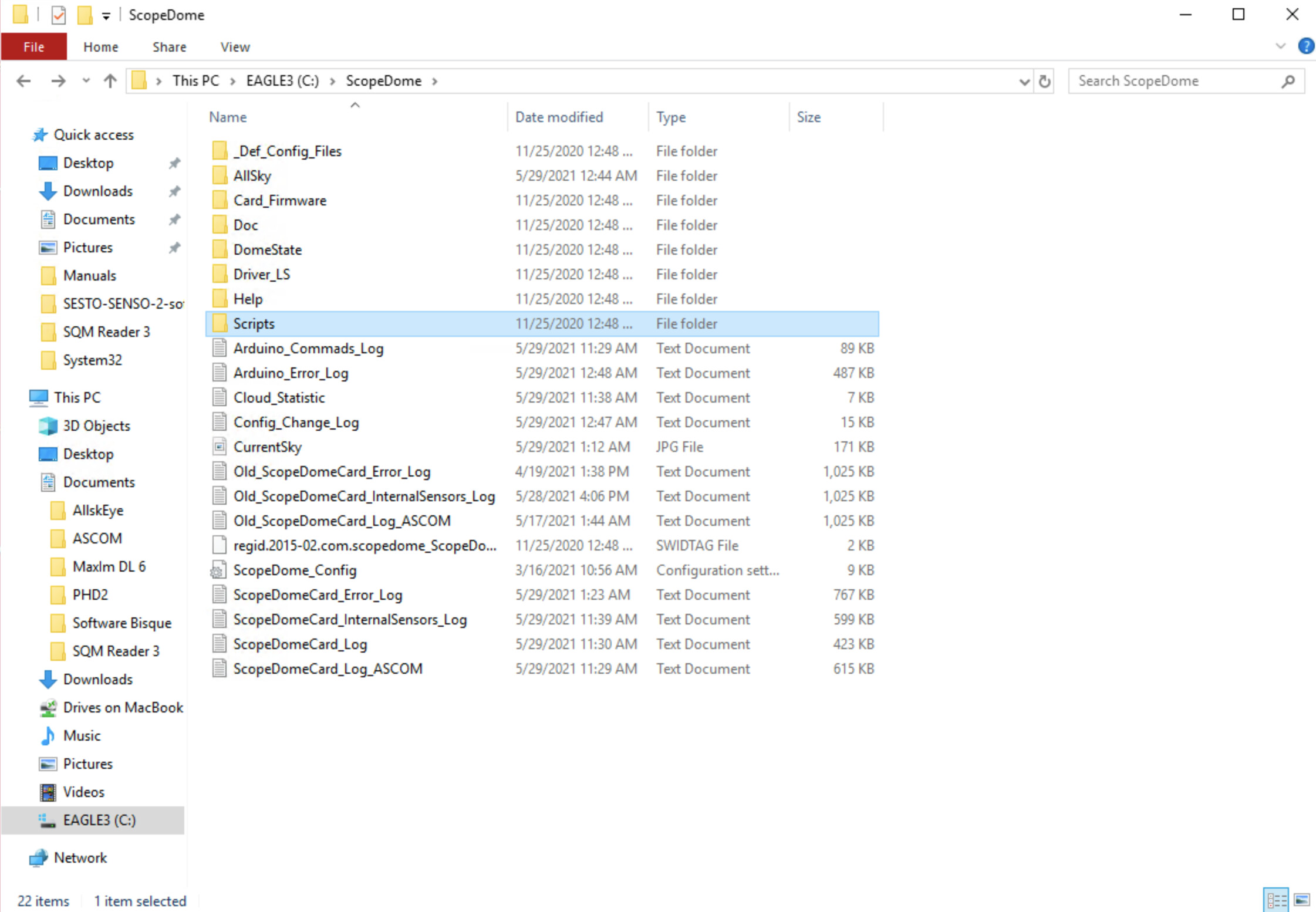

There are allot of scrips here and I am unsure which one to share.
Here is a screenshot of what scripts I can find. Let me know which one you would like to have a look at?
