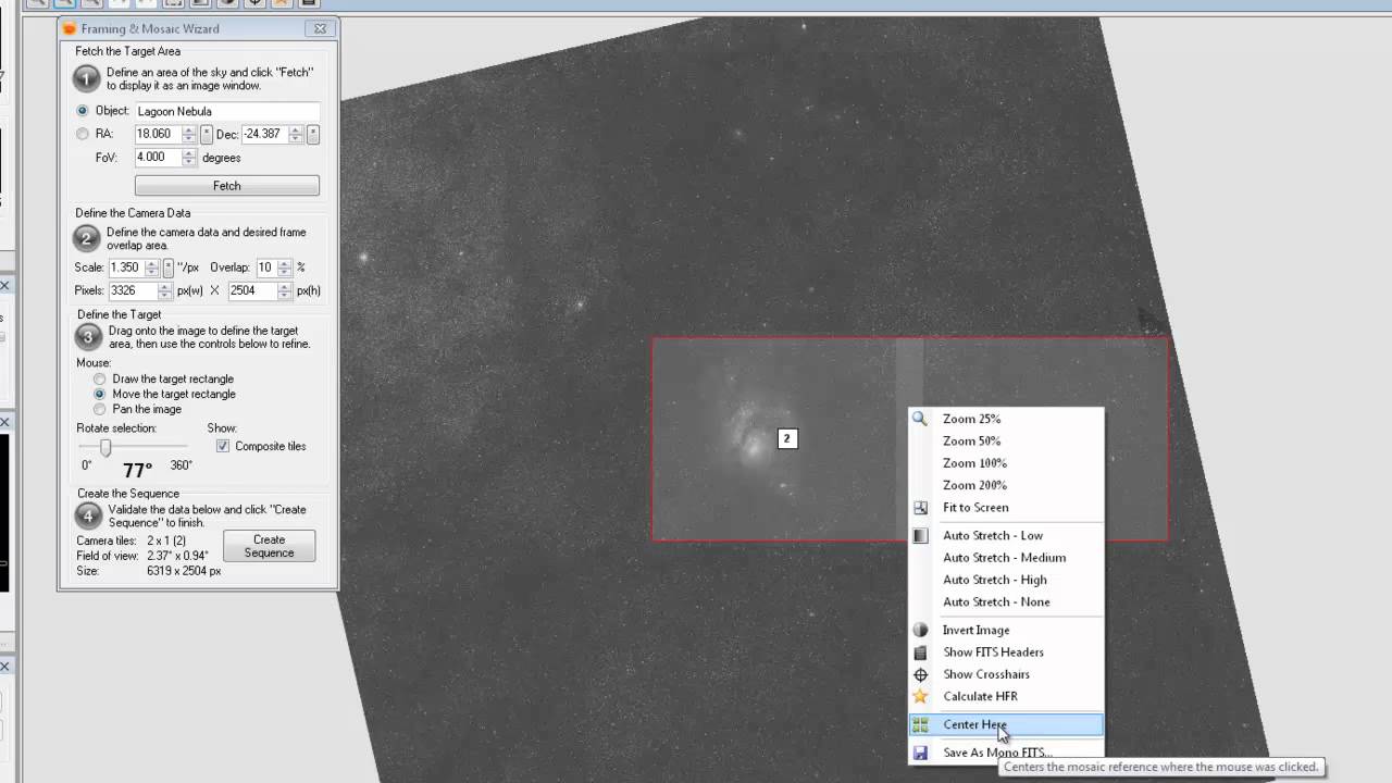

Although you can manually put in the target’s coordinates, there are some easier ways.
One way is to grab an existing image of your target and plate solve it. There are a couple ways to do that in SGP:
  • open the image, right click, Plate Solve, then check “use these results as the reference image for target”, or,
  • in the target settings, click Browse, open the image file, click Solve. SGP fills in the location from the solution.
But I think the best way to get the target coordinates is to use the Framing and Mosaic Wizard. Although it is a paid add-on it has a free trial period, you should definitely give it a try!
Andy
There are a lot of options for populating the coordinates. Some of which Andy has pointed out. You can also use images from Flickr or AstroBin that have been solved. You can find more info here:
http://www.mainsequencesoftware.com/Content/SGPHelp/LocationToolsPlateSolving.html
And I agree the Framing and Mosaic Wizard is probably the best and most straightforward method. Not just because it’s an additional purchase…but this is what I use as well. I think most people that have used it don’t look back! You can find a short demo here:
