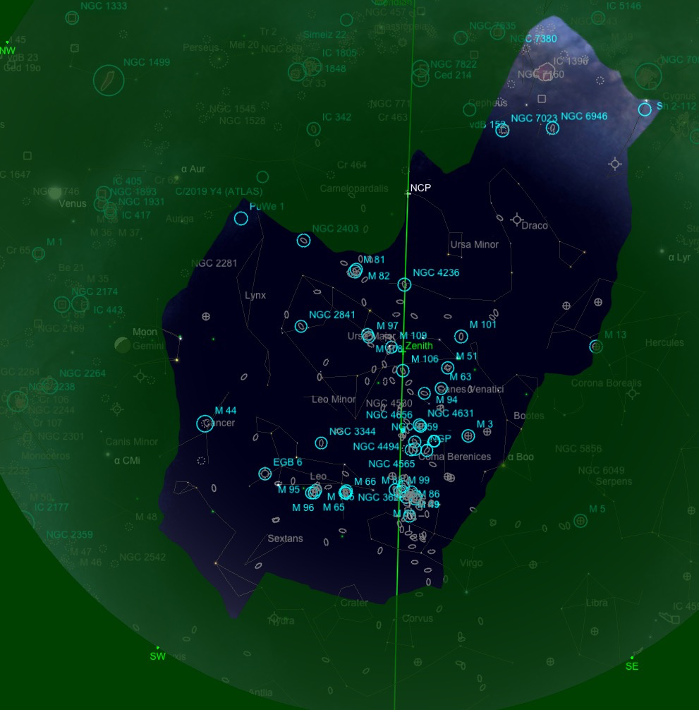

Hoi, I am phasing the same issue here. You see that there some improvement can be made in SGP. I mostly run 2 or 3 objects during the night. Fully automated including flip and focussing. I need to schedule every night a session separately. I use in side SGP the framing tool to frame the objects and use the planner function to start and stop sequence. Outside SGP you need to do some calculations how many frames you can shoot before the sequence is completed to avoid parking. You also check for overlapping objects seq/times so calculated when you start and stop different objects. I have script for calculating the amount of exposures GitHub - calberts/SGPXExposure: SGP Planning Amount of exposure. I use SkySafari to estimate when the objects are/become visible for my location, see below picture, for that I play with the time in SkySafari. Example the picture below of SkySafari, that’s round 23:30. I have I phone app to create the horizon for SkySafari. Today while everything is automated, this is the hard work ;-). but on the other hand, also nice to do! The objects I select over period mostly checking via astrobin. The blue circles are object as part of the observing list you can create in SkySafari. I still struggling with some issue. stopping the sequence while it is not complete I have not the feeling I am in control there yet. But that is also lot trial and error. Please some else can also explain his procedure so Matthew can pick up what the best works for him, anyway hoop that this helps.
