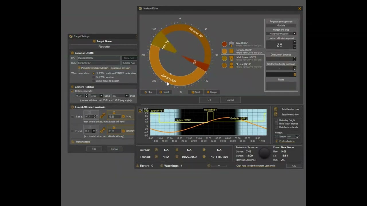

New Feature: Custom Horizons!
This release will come in 2 parts:
  • The first, delivered in 4.3, will focus on definition of custom horizons for your User Profiles, display of horizons on the Planning Assistant (target transit) and, finally warnings produced as a result of how the target interacts with the horizon during your capture session.
  • The second, likely in 4.4, will integrate the target - horizon interactions into the sequence in two ways: 1.) Using the horizon as default minimums for target start and end. For example, if you specify starting at a target altitude of 25 deg, but the horizon indicates the target will not be visible until 32 deg, the start time will be adjusted automatically (and displayed). Or you may have specified a target end time at 01:30, but the target goes below the horizon at 00:45. In this case, the target may end earlier (see #2 for the “may” part) than requested and move onto the next target. 2.) Second, allow the sequence to be more resilient when interacting with obstructions defined in the horizon. For example, say that all kinds of failure happen when your target goes behind some trees, but those trees only occupy about 3 degrees of azimuth and when the target clears them, it will still have plenty of good imaging time left before it sets. Instead of failing or going into a recovery mode, SGPro will patiently wait for the all clear on the other side of the trees (and will also display what it is doing and when it will be clear).
For the first part of custom horizons in 4.3, here is a quick video so you can see the editor, target overlay and warning system in action (make sure to click the gear icon and bump up the resolution of the vide so you can read the text):
More here:
